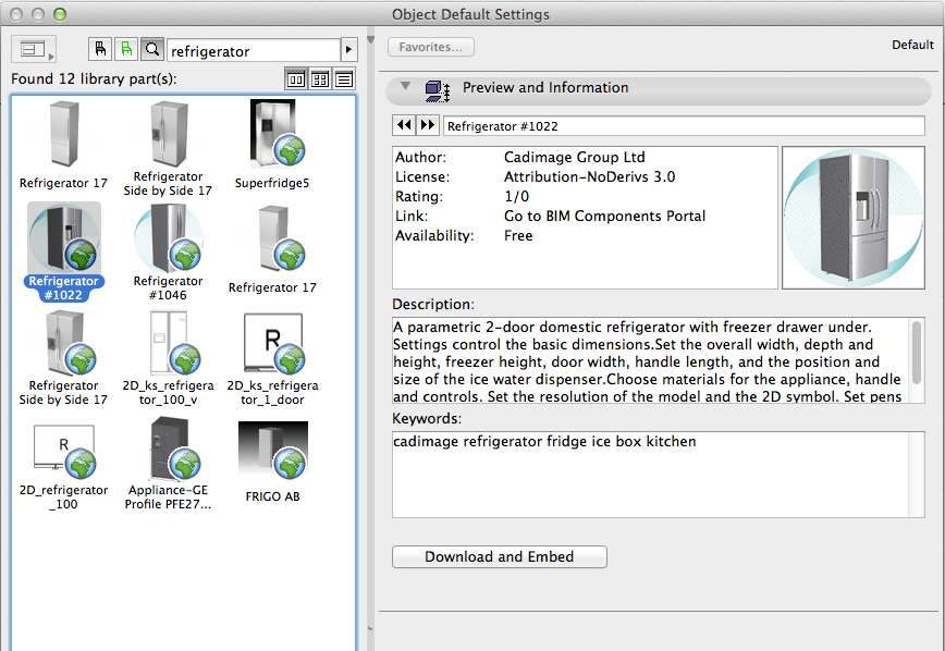

Jonathan wrote:
My clients would like a counter depth refrigerator with a freezer drawer below
and either a single or double door into the refrigerator section.
When you enter a search term in the Object Settings dialog, both the local libraries AND online resources are searched (available downloads - globe icon). See attached screenshot that shows the refrigerator 1022 or 1046 as possibilities for you.
Or, go directly to bimcomponents.com and search:
https://bimcomponents.com/Search/refrigerator
Both of these are from Cadimage and are highly parametric (open the Settings panel). The water dispenser and handles cannot be made invisible though, only changed in size and/or position.
If the result is not parametric enough to change the shape or handles... then convert it to a Morph and edit the morph as desired. (You can optionally resave the morph as an object, although it will no longer be parametric.)
