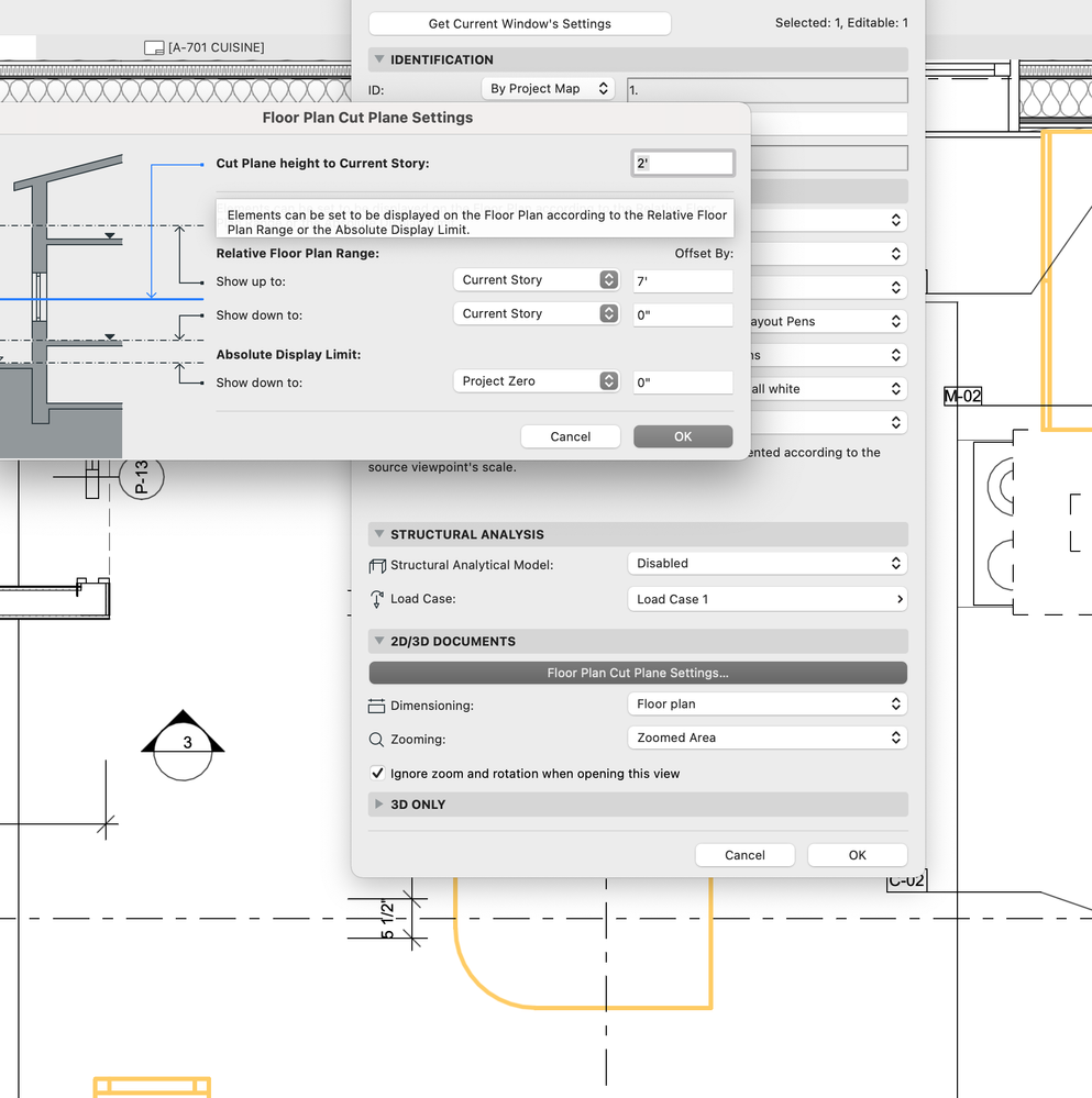

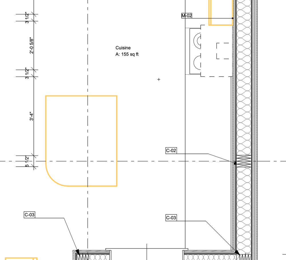

- I am detailing a kitchen and want to include above and blow kitchen counter plans.  When i set the cutting plane lower than the counter height, i still don't see the cabinet sides...  What am i doing wrong?

@Polar Bear Archicad's 3D objects typically only ever show a top down projection on a floor plan, they don't respond to cutting planes. Your best alternative is to create a 3D Document with cut planes at the required height, this usually works depending on your expectations from the 3D model and what has been included by the developers.
