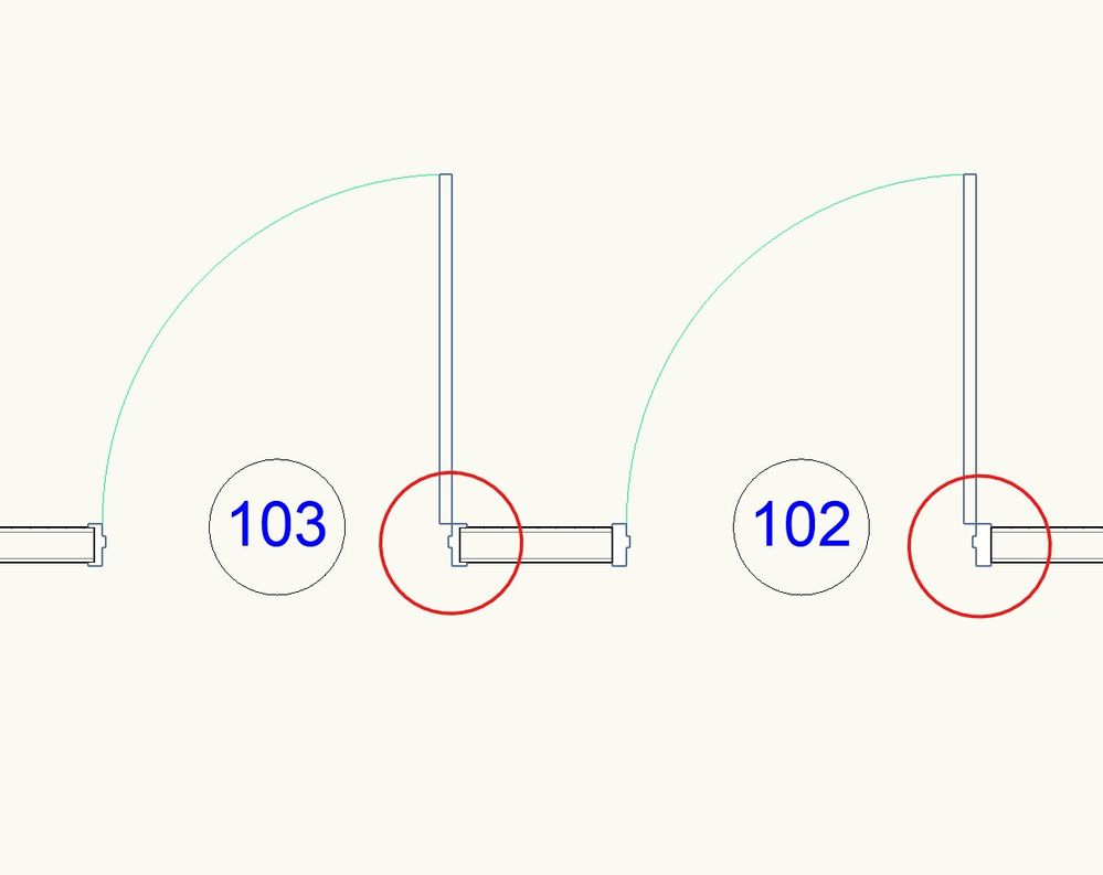

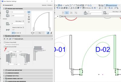

Hello all,
I've somehow created two distinct doors and cannot find the difference in the settings between the two. The only difference I see is that the rough opening on one has an oversize and the other does not. Other than that the two doors are identical, but I'm not able to figure out what parameter I changed in order to get the Unit Size and the Rough Opening size to match. In floor plan one door wraps around the frame, and the other is flat against the frame. Both doors have the "Frame Surrounds Wall" option greyed out but checked. I also can't seem to reproduce the effect of the "flat" door frame that doesn't wrap around the wall with a new door. Both doors are the D1 Commercial 24.
Anyone have any insight on this? I'm not really looking for a solution, I'm just curious if this is a bug or if there is a setting somewhere I'm missing.

I have been fooling around with the door in in 25 ( D1 Commercial 25 ) and managed to get the same result as you, however, I am not sure how to generate the anomaly again.  It's complicated but I have done it more than once.
This is part of it --
How the "Frame Surrounds Wall" function is active or not active has something to do with it.

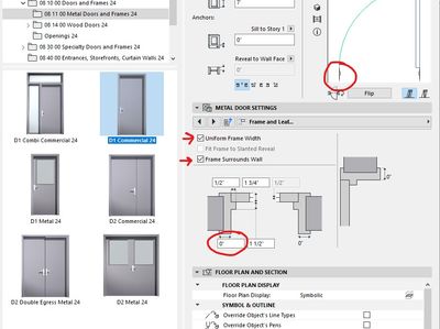

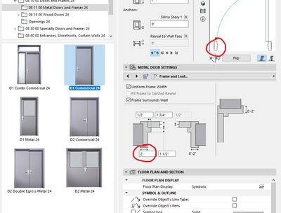

I believe I figured it out, it looks like when the door frame width is set to 0, and then set back to another value, the frame no longer "surrounds" the wall, it sits on top of it. Notice how in the images when the frame is set to 0" it becomes a flat line. The only way I have been able to figure out how to fix the issue is to reset the door's settings, either by selecting a different library part (For example D1 Metal 24) and then selecting D1 Commercial 24 again, or selecting the "Reset to Default Settings" option. This of course means you'll have to redo all of the settings you've changed.
https://youtu.be/HIxGes94obA
I'm assuming this is not the intended outcome when changing the door frame width, so I guess this is a bug? Also I seem to only be able to set the frame to 0 when "Uniform Frame Width" is checked.

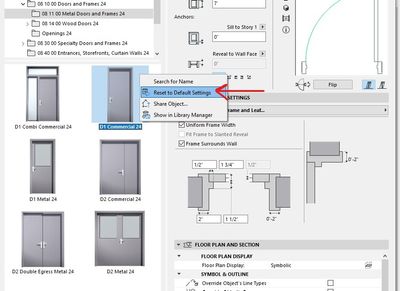

Thus, I have entered it as DEF-6842. The only workaround here, as you already found out, is to Reset the door with its default object settings.
