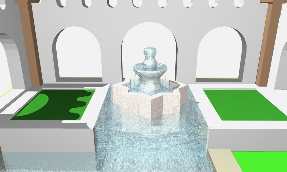

Hi guys, i have created this fount with different archicad elements, i want to save it as a gsm and be able to edit and modify its materials, and use it in further models. Someone can help me with this??? thanx....

Hi QW, thanx for your reply...un fortunatly that is what i always do to create my objects and use them in my other models, the problem is that i still cant find out the way to modify its materials (parameters).
Thanx anyway...
You will need to learn a little GDL and add a parameter for each material that you want to alter.
Then search through the 3D script and replace the hard coded materail with the new parameter - you will see it as ... "water" for example in the script.
Make sure you delete the quotes when you swap it for the parameter.
