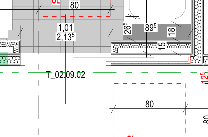

Hey,
I am having a bit of a difficulty with the appearance of a sliding door as a ground plan. There's a line coming out of the centre of the door (marked red, 1,01 /2,135), which I thought was a part of the Marker (working with a German version here, so not certain how's it called in English). After fiddling with the definitions of the door and the marker I still couldn't remove that line.
Any suggestions how to get rid of it would be highly appreciated !
(I'm working on a project that has been downgraded for me from AC 20 to AC 19)

Hi IDAIDA,
in German AC-Version:
Capital Letters for better understanding only.
MARKER-EINSTELLUNGEN // MARKER GEOMETRIE // (4) [ ] LINIE VERLAeNGERN.
HAKEN RAUS
German forum : http://forum.graphisoft.de/
Best regards
Mario
thanks for suggestion
that box on the location you've mentioned isn't selected though, and the line is, as you can see from the attached file, very much present
Any other ideas?
