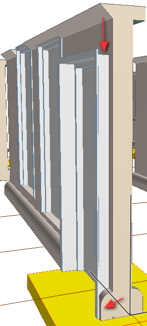

door trim issue in Complex Profiled Wall
Hope someone might have an idea on what might be causing this weird door casing stand off on a Complex Profile wall?
It is a D1-12, but happens with other doors also.
Trim only stands off on one side, opposite of swing of any door.
Seems I've gotten this solved once before, but looking at parameters for wall and door, I have not been able to locate it, yet....
Thanks

Check the Opening Reference in the Profile Editor for that wall type. Curious though that the jamb is unaffected.

Update:
My C.P. reference opening line was away from my C.P. wall edge, now corrected, but unfortunately that was not the problem, (I did a double check
on that).
However, have now worked with the D1 door some more and found out:
1. If I set the height of the bottom of my door 1/8" (or more) above top of slab all goes back to normal.
2. If I then try to lower the door back to 0" from the dialog box, the casing goes wack again.
3. However, I can drag the door down below the slab even an inch or two to negative numbers and casing stays ok.
4. Then tried to raise door bottom back to 0" in dialog box and door goes wack again!
5. And, if I set the bottom of door to a neg number, all is ok also!!
So, my conclusion is that D1 12 (or others) mostly do not like 0"
