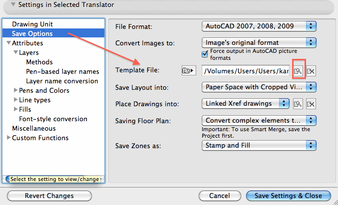

In an ideal situation (that I have yet to encounter), the person to whom you are sending the DWG has their own standard layer names. Have them send you an empty DWG file with that info in it. In the DWG translator set-up, you can create a special translator just for them which uses their blank DWG as a 'template' file.
Then, when you do the layer-to-layer translator, the ArchiCAD layers will of course be in the ArchiCAD drop-down list - but now instead of having to type the client's layer names, all of the DWG layers from their template/reference file will show up in a drop-down list for the target layer.
See attached screenshot for where you attach a template DWG to your translator... next post will show how to use it...
Karl

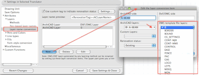

Karl Ottenstein
Moderator Emeritus
This last screenshot shows creating a new layer-to-layer translation entry with no typing - only selecting AC layers from a drop-down list, and selecting client-target DWG layer names (from their template file) from a drop-down list.
The layer names shown are kind a little strange - AC default template, and a survey dwg from an engineer - but illustrate the process anyway. 😉
Cheers,
Karl
