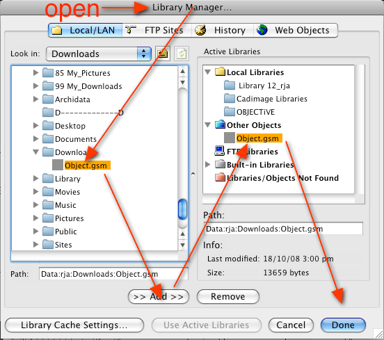

Help, I don´t understand how to get the gdl objects in to my model. Please descibe to me like a 4 year old step by step from tdownload to the model. When I download the object first "land" in a download mapp at my Mac and where do I put the object from there and attach it in to the model?

Open the Library Manager and select your object, then add and reload the library.
OR
If your library is not a container put your new object in an appropriate folder of your loaded library, then reload.
