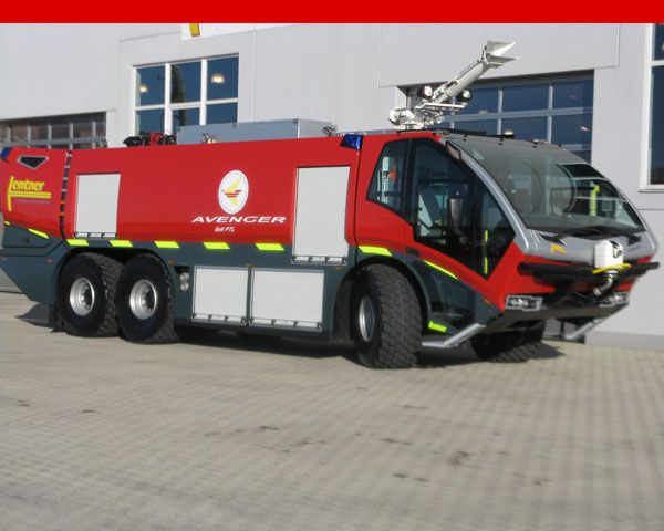

my second working object. a german Lentner Crashtender 6x6

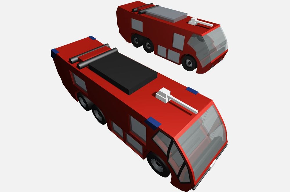

FIRE TRUCK:
I think as a basic first try with creating new objects, im happy with it.
THE FRONT TRUCK IS THE LATEST VERSION !!
Enjoy.

getting better.......
