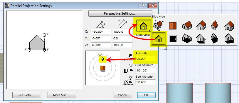

i have modeled using slabs a nice clean fire house door.
I want to save it as an object and bring into into an exisiting project.
Then rotate it, so it is standing up.
I have made it and saved it.
Now i need to get my head around exporting it as an object file and bringing it back in.
Im kinda loos now
Help me please.
Thanks.

pixpast wrote:
there must be a easier way of creating an object from plan and then flipping it up 90 degrees.
Eduardo mentioned the trick earlier in this thread.
In the 3D widow you need to set the projection to the view you would like to see in plan.
So you will need a side view with a camera azimuth of 90°.
In 3D it will appear as if you are looking at the top of your fire truck.
Now you save this as a 3D object.
It is no use just rotating the 3D view - you must set the projection settings.

"Barry Kelly" wrote:

barry where do i change the projection settings ?
I have set up a camera with the program still wont let me export as object ?
Ian

i just need to understand where i can set the perspective view thing, so i can save this out as an object in the correct elevation.
also i am contemplating how to add a round barrel to the water gun ontop of the fire engine ???
