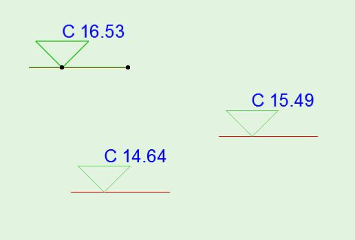

how to make editable GDL Script ?
!ADD2 0.5, 0.4
hotspot2 0,0
hotspot2 a,0
PEN epn
LINE2 -0.5, 0.0, a, 0.0
PEN cpn
LINE2 0.0, 0.0, -0.4, 0.4
LINE2 -0.4, 0.4, 0.4, 0.4
LINE2 0.4, 0.4, 0.0, 0.0
DEFINE STYLE "AC_STYLE_1" "arial",
100*tsize/a_, 7, 0
pen tpn
SET STYLE "AC_STYLE_1"
C=""
C=str(int((y~*100)+.5)/100,3,2)
TEXT2 0.0, 0.377143, "C "+C
this is my script. i want to make it auto editable. my c value generate automatically when i copied an object.
anyone please help me

This script seems to work fine.
It will show the 'Y' value (height in elevation) and changes automatically as you drag it or place new objects.

@Barry Kelly. actually i want that amount editable. it takes automatically.. but i want script where can i put my own value...for example you gave me an example take value c15.49 from them and that place can we change 15 to 17. is it possible?.. can i change my value in GUI screen? appart from coding part. directly where the triangle.
To make it completely editable you will need to comment out the lines in the script that refer to the C parameter.
Then create a text parameter "C" in the parameter list.
Now in your object you can type any value you want - but it will not change automatically as you move the object.

If you want the best of both worlds you can add a boolean (on/off) parameter to switch between automatic and maual input.
Create a boolean parameter called "auto_input".
Also create a text parameter called "manual_text"
Then change your script to this.

if auto_input = 1 then
C=""
else
C = manual_text
endif
Now in the parameters you will have a switch where you can change between automatic or manual input.

Thank you... its working with your help... thank u so much
