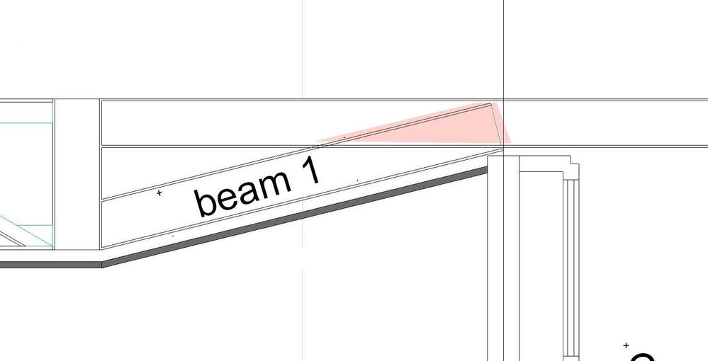

how to trim top of angled beam
i want to trim the pink hatched area off the top of "beam 1", which is "universal columns beam 13" object in archicad 13.
i have tried cutting angles and cut type horizontal, perpendicular and vertical but it wont work
4 Replies 4
use Solid operations
Erika Epstein
Just increase the Beam priority of the horizontal beam so it is higher than the angled beam.
Conversely lower the beam priority number of the angled beam.
Erika
Architect, Consultant
Mac OSX 10.11.1
AC5-18
Onuma System
Erich
Just to give another solution... you can also use the trim to roof function.
Erich
AC 19 6006 & AC 20
Mac OS 10.11.5
15" Retina MacBook Pro 2.6
27" iMac Retina 5K
Erika Epstein
In this example trim to roof would require you to add in a roof with which to trim.
