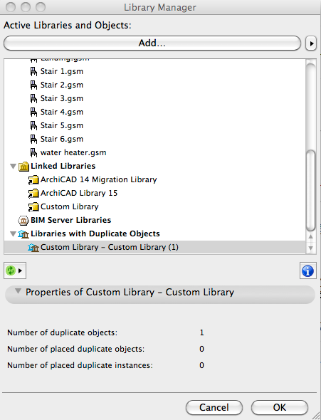

so i added the custom library folder with the library manager, and i shows up there, but now it says there are duplicate library parts. how and where do i find these? if i click on the "libraries with duplicate parts" thing there is another thing that says i have "custom library - custom library (1)" i can't delete this, so all i can see is to delete my custom library. then i have no custom library. i can't find this duplicate they're talking about.

Did you place your Custom Library inside one of the other loaded libraries? Also, using the Library Loading Report palette will give you more detailed information about the duplicates.
