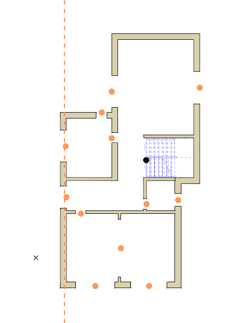

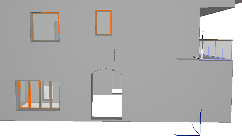

my openings in 2d plan, dont show window and door openings
Carina_daniliuc
Hello, my doors and window aren't showing in the 2d plan and in 3d the doors aren't showing just the opening of the door

That symbol you are seeing indicates a missing library part.
A small primer on the issue: https://community.graphisoft.com/t5/Libraries-objects/How-to-detect-and-clear-missing-Library-Parts/...
Basically you can restore the library you used for the doors (maybe the basic library is missing) and they will appear.
