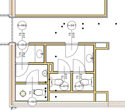

In Archicad, you can store objects and textures inside the project (Embedded Library) or in external locations (Linked library). To check and manage the project libraries use the Library Manager. If a linked library is not accessible by Archicad, library elements have a "missing" state and they are displayed with a solid spot placeholder in place of the original element’s origin point in the floor plan view. Missing library parts are also listed in the Library Manager dialog.

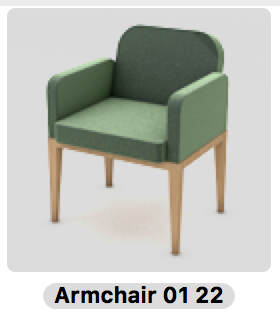

In general, it is not recommended to edit the content of the standard Archicad library since it contains also some files that are essential for running Archicad. To prevent any unexpected changes, the library is stored in .LCF (library container) format in the Archicad installation folder. However, if the folder content is deleted partially or entirely, missing objects will show up. Standard Archicad library parts always have the version number in their name by default. E.g. Armchair 01 22, where „22” refers to the Archicad 22 version.

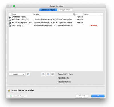

  • If the number in the missing parts’ name meets the version number of the running Archicad, open the Library Manager (File/Libraries and Objects/Library Manager), and check the standard ARCHICAD library in the list of libraries. If it is not there, add it to the project and click Reload & Apply. (Add a Linked Library)
  • If the Archicad library is added, check the folder content by selecting the library in the list, and clicking the link at the „Library loaded from” dialog area. You can reset the content of the folder by copying/pasting the folder content of a standard Archicad installation.
  • If the number in the missing parts’ name is lower than the version of the running Archicad, Open the Library Manager, and click the Migrate Libraries button. Library migration will add the Archicad Migration libraries located in the installation folder. If there are still some parts missing from a standard Archicad library, check the folder content by clicking the link at the „Library loaded from” dialog area. If necessary, you can reset the content of the folder by copying/pasting the folder content of a standard Archicad installation.

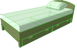

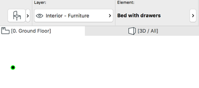

Embedded Library Part Used as Macro
It is possible to save an existing library part as a component of another custom library part. In such a case, the GDL script refers to the embedded object by the name of the original library part which has to be accessible.
Info_18x18.png NOTE: Archicad library migration does not migrate embedded library parts. Example workflow of creating such objects: Standard Archicad Bed 21 Object + underneath drawer modeled with Morphs are saved as custom library part (Bed with drawers.gsm) in Archicad 21.

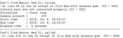

The project opened in Archicad 22 with libraries migrated: there are no missing libraries in the Library Manager, however, the library part is displayed with a solid spot.

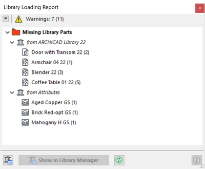

In this case, check the Report window, which will list the name of the missing embedded object as well as the custom object with its Element ID:
To make the object visible again, do the following:
  1. Add the missing referenced object or library to the project (this may cause some duplicates in the loaded library temporarily) to make the object visible in the project.
  2. To eliminate the embedded object reference from the custom object's GDL script, convert an instance of the custom object to Morph and re-save the custom object.
  3. Remove the unnecessary library or object in the Library Manager.

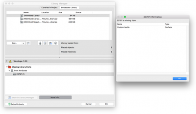

Textures Referenced by Attributes
Archicad attributes, such as Surfaces and Image fills may use bitmap images stored on external locations. If the image file is not available, missing attributes will be listed in the Library Manager. If you click the More info button in the lower right corner, an info panel displays the type and name of the relevant attribute.
Missing attributes however do not make the object fully invisible. The object will show up both in 2D and 3D with the missing attribute substituted by a black-purple pattern.
