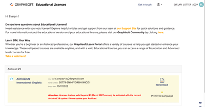

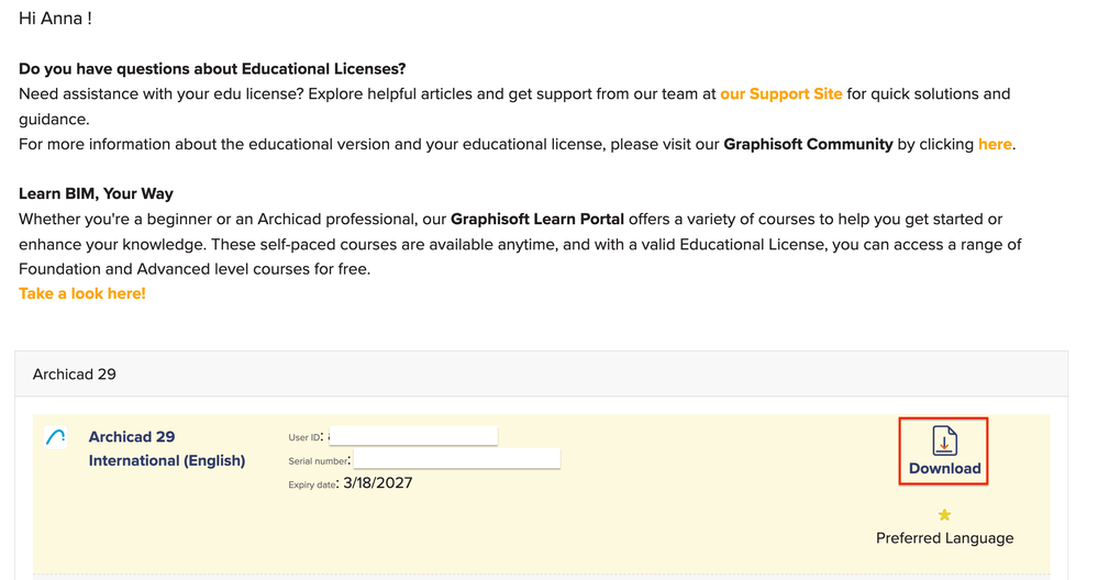

That is the final step! Log in on the MyArchicad page. You can see that there is available a new serial number with a 1-year expiration date.
Now, when you start Archicad, and it requests your user and serial number, insert your email address (The same one you have for the Graphisoft ID) and the new serial number.
Here are some tips:
You got your serial number. Now let's install Archicad to start working on it immediately!

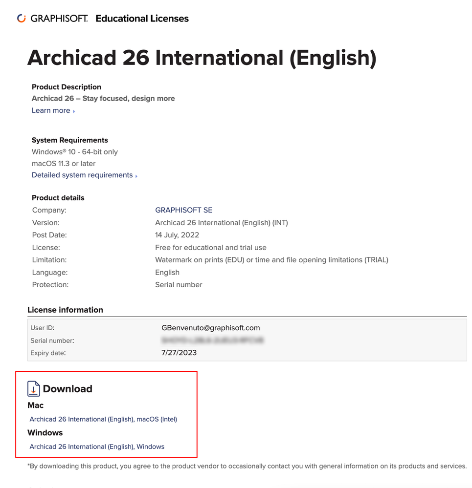

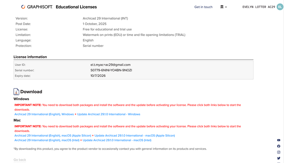

On the MyArchicad page, on the right side of the serial number, there is the download button, which is the adequate version of your serial number.
By clicking Download, you get redirected to the page below, where you can find more details about the Archicad version, such as System Requirements, License details, and the link for Downloading on MAC and Windows. Only the appropriate version can be installed on the corresponding hardware.
Important: Download both the current Archicad version and the corresponding update. Both must be installed in order to use Archicad successfully.

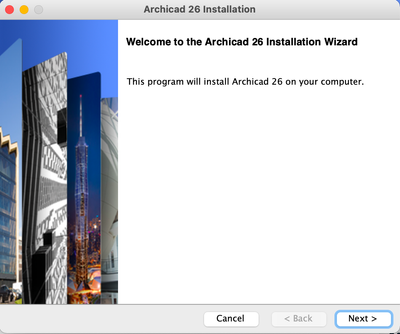

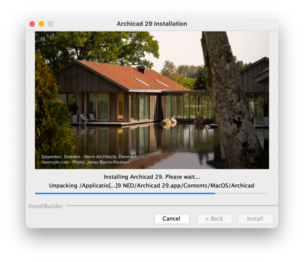

After downloading the Archicad installer, run the installation file and install Archicad.

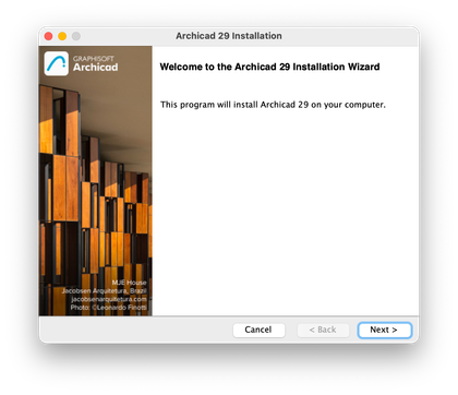

Start the installer to open the Welcome Screen.
Click Next to continue.

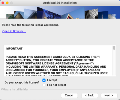

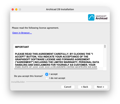

Read the license agreement carefully and accept it. Click Open in Browser to see the Agreement in a new window. Click Next.

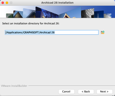

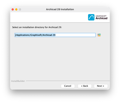

On this page, define the file path of the installation. As a rule, you should choose the path suggested by Default to simplify the installation of any future updates.
To confirm the file path, click Next.

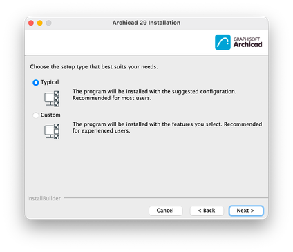

Choose Setup Type
With the Typical installation option (recommended), you will install Archicad with all the components (e.g.: Library).
Alternatively, choose the Custom installation option to install only specific program components.
After you make your choice, click Next.

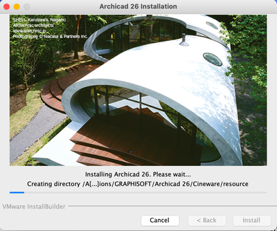

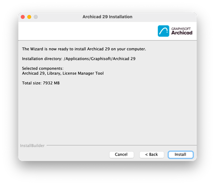

Click Install to begin the installation.
Depending on your Hardware configuration, this process may take several minutes. In addition to other components, CodeMeter, the BIMx Desktop Viewer, and the License Manager Tool are all installed in the background.

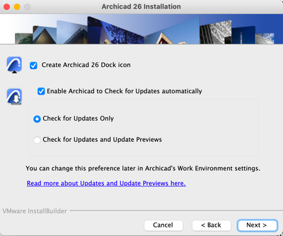

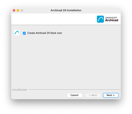

Shortcuts
Here you can create an Archicad Desktop shortcut.
Review the setting to Enable Archicad to Check for Updates automatically (checked by Default).
Confirm your choices by clicking Next.

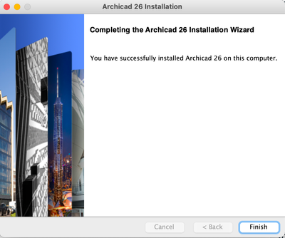

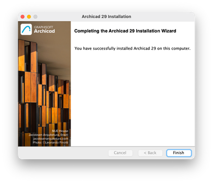

If the installation process includes installing CodeMeter, it is required to restart your computer now.
Click Finish to complete the installation process. You may be requested to restart your computer.

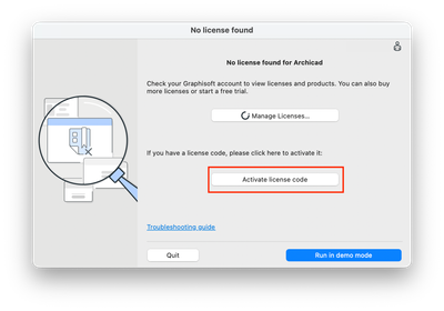

To unlock all features in Archicad, you must activate your educational license. Without a license, Archicad starts only in demo mode, in which you cannot save.

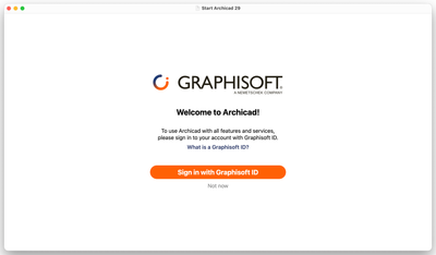

1. Start Archicad.

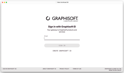

2. From Archicad 25 onward, additional authentication is required to use Archicad. In the Archicad start menu, you will be prompted to log in with your Graphisoft ID. Your Graphisoft ID is the email address and password you also use to log into your myArchicad account. If you do not yet have a myArchicad account, you can register for free at https://myarchicad.graphisoft.com/
3. Enter the email address and password you use for your myArchicad account and click Sign in. If you do not see the orange sign-in button, simply scroll down a bit.
Note: If the window shown above remains empty, please update your graphics card driver.

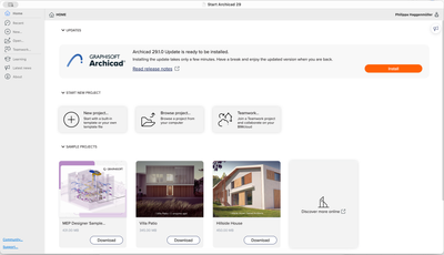

4. You are now logged in and can either create a new project via the side menu on the start screen or in the main window under Start New Project, or search for an existing project.

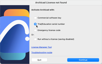

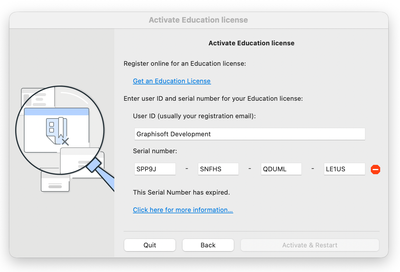

5. Archicad will then prompt you to activate the license. Select Activate license code. In the next window, select Educational license.

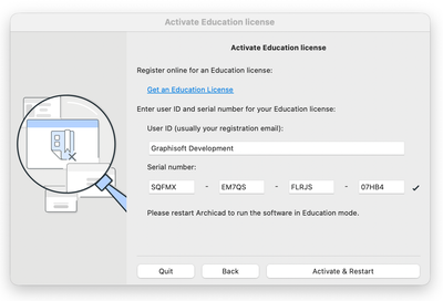

6. Now you need your username and serial number. You can find this information in your myArchicad account. Log in to your myArchicad account at myarchicad.graphisoft.com and locate your license details. Make sure that the selected serial number matches the Archicad language version you installed. The International Archicad educational version (INT) can only be activated with the international serial number. The same applies to other language versions.
7. Enter your username and serial number in Archicad to activate the license. It is best to copy the data directly from your myArchicad account and paste it to avoid typing errors. Once the data has been entered correctly, a checkmark will appear next to the serial number and the Activate and restart button will become active. You can now proceed by clicking Activate & Restart.
Warning: If you receive the error message This serial number has expired, there are two possible causes—please check both:
- You entered a serial number whose validity period has already expired. To obtain a new, valid serial number, simply renew your license.
- You entered a serial number whose validity ends after March 23, 2027. In this case, you can only activate the serial number if you have installed the latest update for Archicad 28 or Archicad 29 (Archicad 28.3.3 or Archicad 29.1.x or newer). If the update is not installed, the serial number will be shown as invalid. Check the download page to see if an update is available for your version. Close Archicad, download the update, and start the installation process by double-clicking the downloaded installation file. Then open Archicad and try activating your license again. With this serial number, you can no longer use Archicad 27 or older versions.

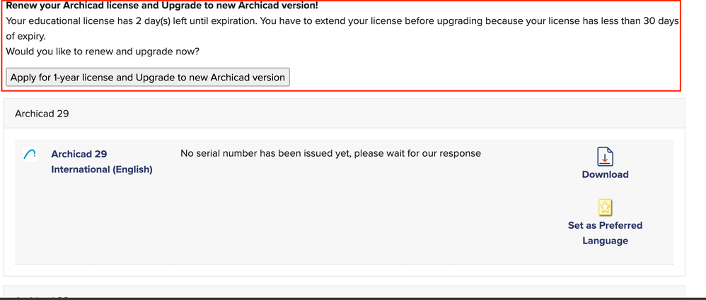

After your first application, there are two options to continue with us:
Renew your license: You can extend your license for 1-year as long as you are a student/teacher.
Upgrade your license: Request a new License for the latest version of Archicad. This option becomes available always when Graphisoft launches a new version of Archicad. Upgrading guarantees the best version of our software and the most up-to-date features!
You can see that both have similar steps. Take a look at the step-by-step:

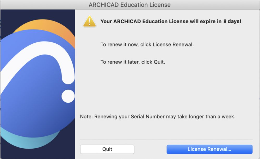

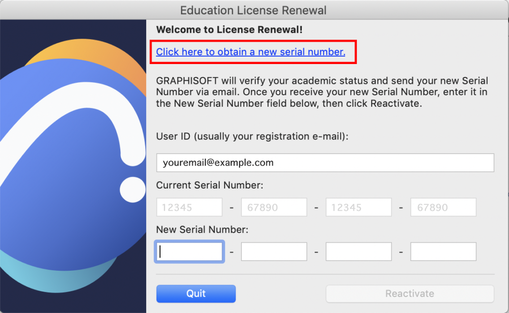

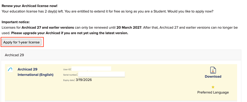

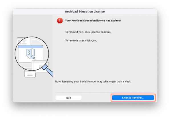

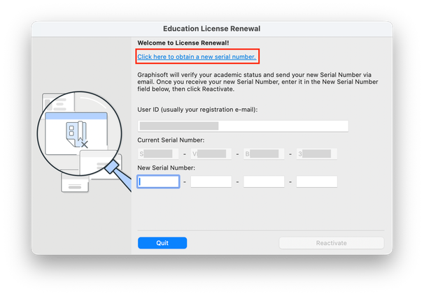

When you open Archicad, and the serial number is close to expiry, it sends a warning message to renew it. Click in License Renewal > Click here to obtain a new serial number.
It will redirect to your account on myarchicad.com. Click on "Apply for the 1-year license".

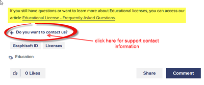

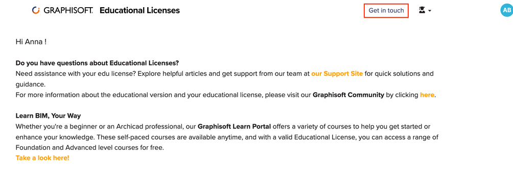

If you still have questions or want to learn more about Educational licenses, you can access our article Educational License - Frequently Asked Questions.

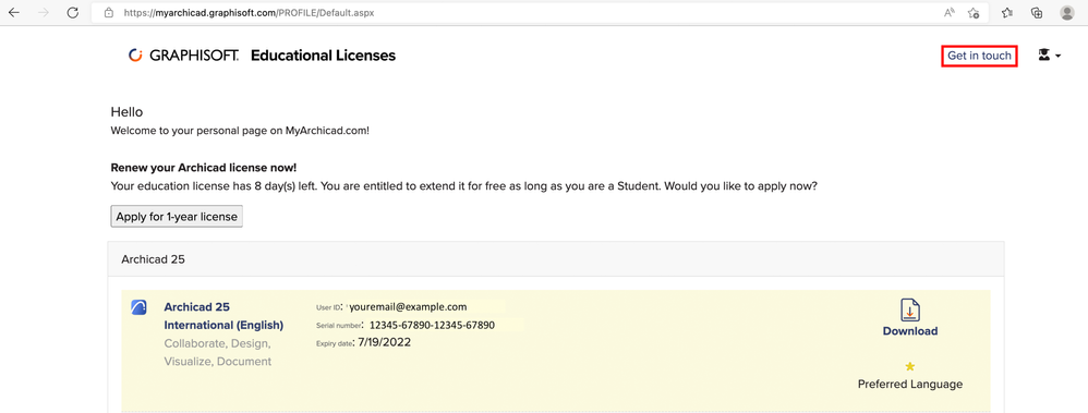

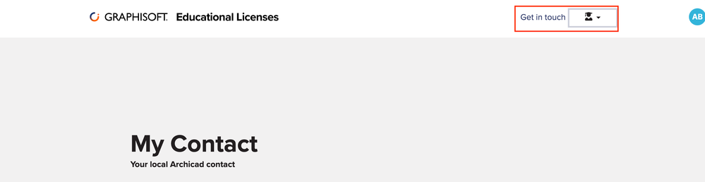

You can contact our local representatives in your region. On your profile on the MyArchicad webpage > Get in touch. As shown in the image below:
