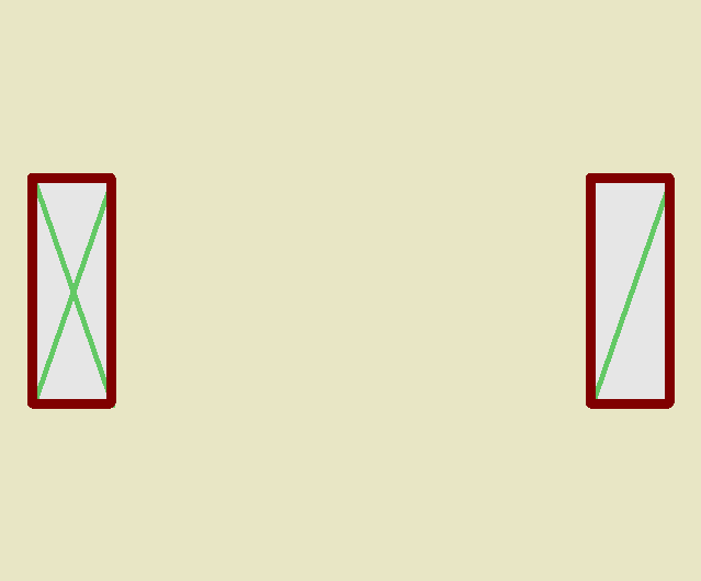

I have a 3D joist object, based on one of the joists from the library. My goal is an object that can be placed in plan and show the proper 2D representation for dimensional lumber, blocking, etc. when viewed in section. The object looks fine when first placed but when the S/E window is rebuilt the infill lines, generated from flat planes within the BRICK that defines the joist outline, display a second black line, behind and thicker than the line defined in the parameters. Interestingly this does not happen with the zero depth section option. I’ve included the 3D script below. Any clue? Thanks.

Here’s an image of the joist after an S/E window rebuild.

.... cut ....
BRICK A,B,C
SECT_FILL 1, 1,1, Si ! Si = infill pen parameter
PEN Si ! or ! IF GLOB_CONTEXT = 4 THEN PEN Si
....cut ...
(because there is the projection of the PLANE --> with PEN gs_cont_pen)
CU mirco
www.cad3d.it
BRICK A,B,C
....cut ...

As simple as that! Thank you. I'm posting the object for anyone who's interested. There's plenty of room for improvement like getting the microlam infill looking right, adding scale sensitivity, etc. but it works well as is.
