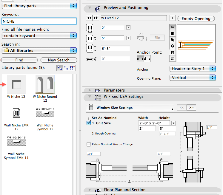

See attached, you should find it in a folder named Wall Extras 13.

Are you using the window tool to place your Niche? See attached.

Found it. Thank you.
Sometimes things gets really confused.
