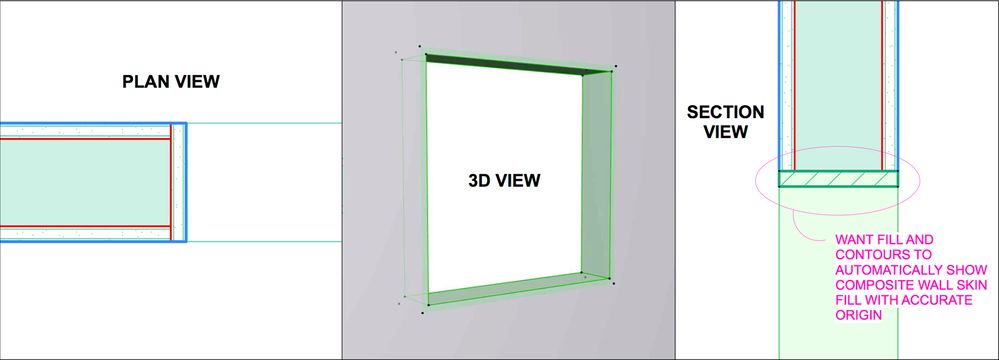

Here's the deal... I was feeling ambitious and scripted an empty window opening where the skins of the composite wall automatically return around the jambs, head, and sill similar to the "turn plaster" feature of all the stock window library parts. See attached image. I got the results I wanted in plan view and 3D view and was feeling pretty good. Then I tried checking the result in a section cut view and discovered a new issue — I can't figure out a way to create the same skin-wrapping results I did in plan view in section. The PRISM I used to represent the finish material at the jamb in the 3D script gives me a cut fill which can be controlled in the 'Floor Plan and Section' panel of the window settings, but I can't figure out a way to script this cut fill to automatically read the wall skin fill like I did in plan view with a local origin and distortion to compensate for composite skin fills that were stretched using the fit-to-skin option. I can't even figure out how I would script a line or anything 2D so that it would show up in a section cut. Is this impossible?

Thanks for the feedback rocorona. I'd read about using GLOB_CONTEXT in
this thread to trigger FRAGMENT layer information in the symbol view, but I was never able to get this working. Is the '2D Symbol' window in the GDL editor the best place to make 2D elements appear in section/elevation?
Also, I guess I want to clarify that I am mostly concerned about the fill here, and want the section fill to be able to automatically read the outermost skin of any composite wall skin I throw at it, not just the particular one shown in the pic. At a minimum I am looking for some control of where the fill's origin starts. You know... a local origin starting at the edge of the finish skin rather than some far off global origin. This is generally not an issue for random pattern fills. However, a lot of our fills (like the GWB fill illustrated here) have a specific thickness and direction and having the cut fill based on a global origin means it's never going to perfectly align within the layer representing the finish material at the head and sill of the window.
Just one thought... in my digging around in the 'GDL Reference Guide' I came across a WALL_POSITION parameter which supposedly reads the starting position of the wall relative to the global origin. I'm wondering if I could somehow use that to calculate where the fill pattern should begin. Again if only I could figure out how to manipulate the origin of the cut fill in section view to start with.

no. The S/E are built by archicad from the 3D model. And this is true also for objects. You have to use the GDL 3D Script.
no time to go further, now, but you need to look at WALL_FILL and WALL_SKINS_PARAMS globals to get the correct fill to use. But I think it would be very hard to align it with the wall fill.

This is what I was afraid of. Except I don't understand how composite walls, slabs, and roofs can accurately communicate these skin fills with the right thickness in the right position.
I ended up using SECT_FILL in the 3D window to define the cut fill to match the skin (with WALL_SKINS_PARAMS global). Results attached... Still can't believe there is no control over the origin or distortion of the fill in section.
