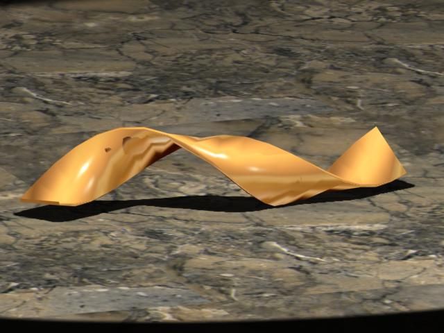

twisted ribbon/object
Hello-
Please show me how this (attached) is done using GDL, I have posted this in 'Working in AC' section. I got a suggestion to bring it here. I have tried the mesh tool before, but didnt work. I would also like to know if I can manipulate/play with the surface of this object after creating it.
Please disregard materials.
15 Replies 15
To do this in GDL will require the correct mathematics.
I haven't the time to noodle it out myself but it looks like a simple circular (sine) function should generate the values if the spiral is to be a regular one. Otherwise you will probably need additional parameters to introduce any distortions you want.
The SWEEP or TUBE statements are probably the best bet for the actual form. I recommend using a FOR-NEXT loop with a PUT statement to set up the coordinates and then use GET within the SWEEP or TUBE. There is some code similar to this in the manual.
Clever application of the graphical (or user) hotspots could make this into a very interesting part.
Durval

thanks guys,very helpfull
Durval, I would like to know how is it possible to make this ribbon start wide and end up thin or almost pointed. the width in the object is fixed all along.
I want it to look more like the one posted by Stuart, except for the thickness.
Stuart, please let me know how long it took you to do it?

The 'one posted by Stuart' is an even thickness along the length. Here is a 'rough' variation which gives tapered ends. As long as you're happy with the geometry/maths this doesn't take long at all.
Note - it isn't an 'accurate' model but would suffice for many circumstances.... Now I'm curious! - just what are you trying to model???
HTH - Stuart
