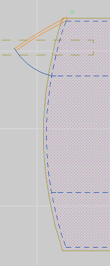

use cabinet builder to build curve cabinet
I tried to use cabinet builder to build a cabinet as picture showing below. It looks like I only can use cabinet builder to build curve door. Is anyone know to build entire cabinet as one object? Or I should build cabinet separate with curve door and group them together?
Thank you!

Yes, i want to know how to build kitchen cabinet in curve with archicadd 10 as well, can anyone help .PLz~~~
Aaron Bourgoin
CabinetBuilder will not build a carcass with the curved shape - just the fronts. The rationale was that the carcasses under the curved counter would be rectangular and therefore encased in a framed finished enclosure. If this is the way you see your millwork piece buillt, then configure the carcasses with the carcass objject and use the other bits to build the front(s).
