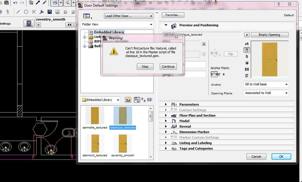

why when i download door library from archicad talk there is
why when i download door library from archicad talk there is problem of warning appear to me many times it disturbing this i downloaded it from archicad talk website GDL library for doors see the warning
please help me to solve this problem i downloaded the winrar file and extracted it in one folder what is the wrong ?
2 Replies 2
In the downloaded rar file there must be a picture object: natural.jpg or natural.png or some other image.
The library object is not finding this file in any of the loaded libraries and so gives the error message.
This picture file must be in one of the linked libraries set in the Library manager.
If it is not in the rar file you downloaded then probably the uploader person of that file was not careful enough and did not include all needed files in the rar file.
Thanks a lot Laszlo Nagy when i uploaded all things related to the door in library manager and tried on one example it works thanks
