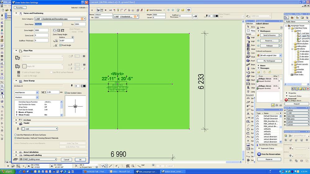

while doing some research into how to incorporate room size into a zone stamp (length x width) i came across the 'LG ZONE' stamp in the object depository. In trying it out, i note that while the area is shown in metric units, linear dimensions are in feet and inches.
All my dimension preferences are set to metric but even when, for example, the ceiling height text is selected to reflect the zone height (entered in metric) it still appears in feet-inches.

Robert, by chance do you have 4D Library. Ben's zone stamp will do this and more.
