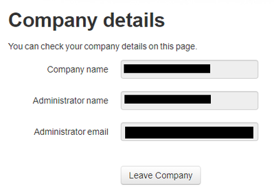

The person who owns the Graphisoft ID can always leave the current company. After signing in, navigate to Company details, there should be a button for "Leave Company"
Then, the Admin of the new company can invite this person to join the new company,
