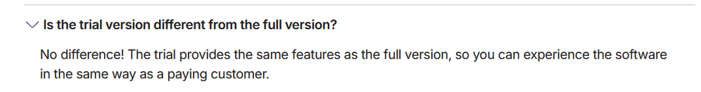

Nurbs
sorry, but GS tells something dfferent:
https://www.graphisoft.com/en-us/trial/archicad/Trial vs Full.png
AC16 - AC29, Rhino 5-8. Alienware WIN 11
That is correct.
You have the full version of Archicad, but the trial files you create can only be opened with that trial version on that particular machine.
Otherwise you can create full working commercial files without purchasing the software.
At the end of your trial you can purchase a license and this will unlock those files so you can then open those file on any machine.
I am just not sure if you already have a license as the original poster does, and then install a trial version because they don't have access to their full version, and then they do gain access to the full version, will the trial files become unlocked?
Or will they remain locked as a trial file because you have not converted your trial license to a new full version.
I am not sure I would want to risk with commercial files.
