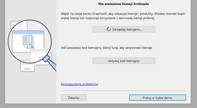

Good morning, I have a problem with managing licenses from Archicad SE2024 (POL). I have three licenses. I could always download the license when starting the program. For some time, during this activity, the license has not been downloaded, but a window with information about switching to license management is displayed. It then directs me to the GSID account and that's it. Licenses are free to use.

Hi @Natalia Rudnicka,
I’ve faced the same situation with Archicad 27 INT 2 times this week & was solved the first time by uninstalling & reinstalling GLMT or (Graphisoft License Manager Tool) but today It was solved by uninstalling & reinstalling the Archicad itself.
Don’t know the reason for that but really that problem annoyed me & wasted hours of my time.
