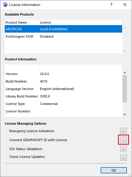

1. Open Archicad with the license. In the Help > License Information dialog, click Connect Graphisoft ID with License button.

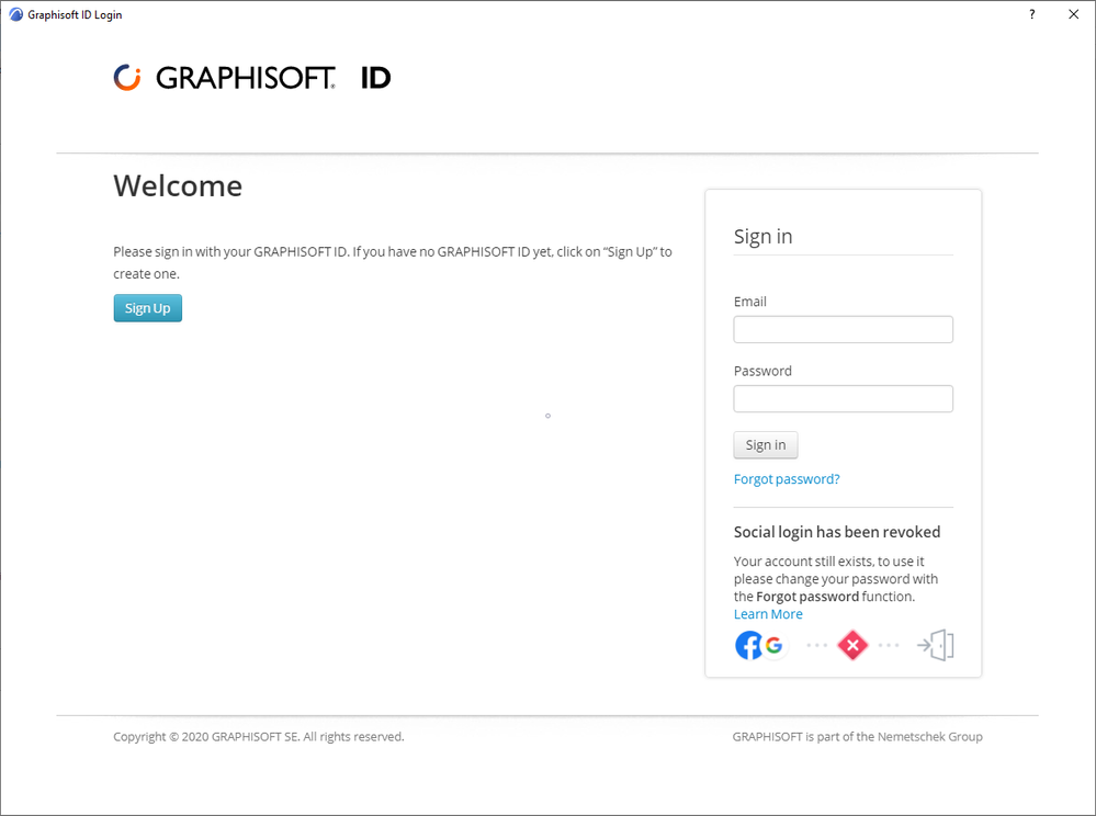

2. Sign in with your Graphisoft ID account (or Sign Up if you don't have one).
