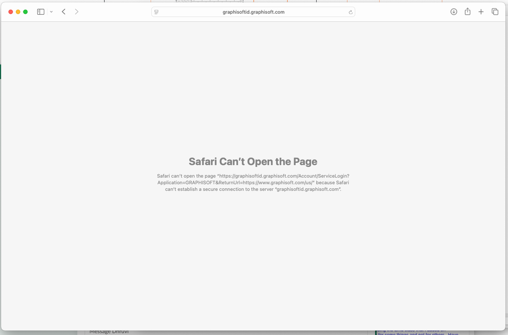

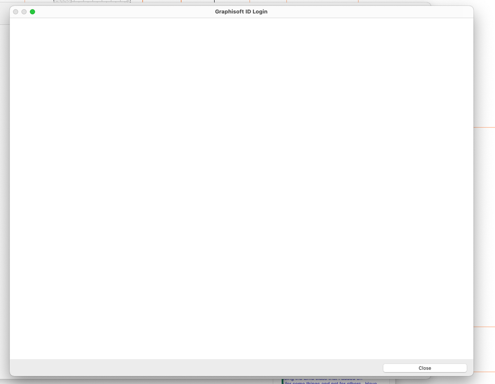

I'm starting off the year with an odd issue.  I needed to upload a BIMx model from ArchiCAD 24, and got an error message saying that I needed to sign in with my Graphisoft ID to be able to do this.  Normal enough, but when I go to sign in and the pop up window shows up, it's blank and I can't sign in.
I'm also getting an error message in Safari when I try to sign in from there saying that 'Safari Can't Open the Page', which makes me wonder if this is an Apple issue.  I am able to sign in from Firefox (which is how I'm posting this).

Problem has been solved for me only.  Everything started working again as soon as I updated to the latest OS (Tahoe 26.2), but this isn't something that is available to my co-worker who has an older Mac.
