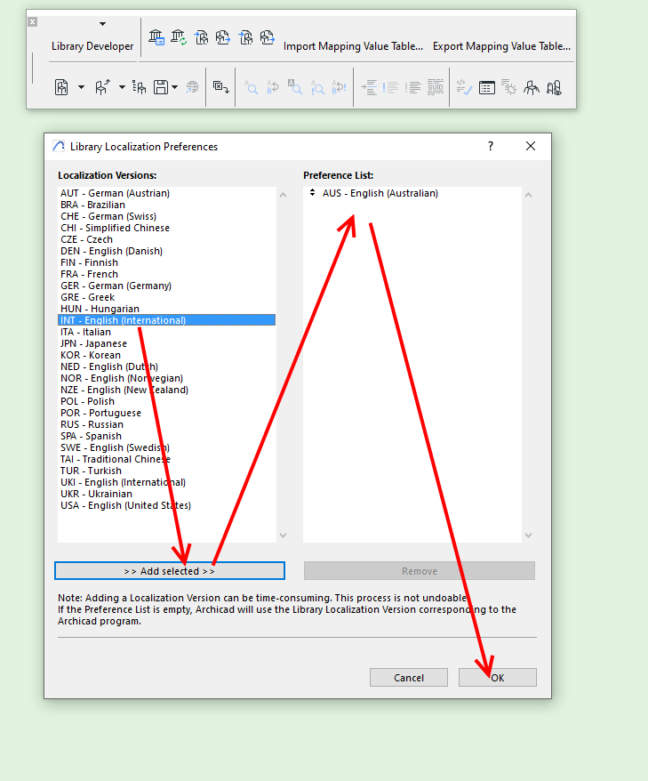

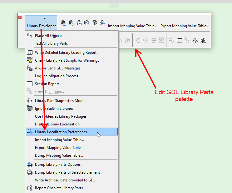

In 28 you can load any of the language specific libraries and in your files (template especially), you can set the Library localisation Preferences.
I don't think this has any affect on the older monolith libraries if you are still using those.

What then @Barry Kelly wrote about libraries is true as well.
Either in USA or INT (or any other) you can load required languages for library so you can eg. work on projects from different country.
