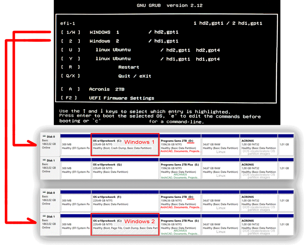

I have two physical drives on one computer.
Each disk generally has at least two partitions:
- c: Windows 10 Pro
- d: Program files, ArchiCAD, my documents, projects, etc.
This isn't a RAID system! The second drive is actually a clone of the first drive and I treat it as an archive for easily copying my work from the first drive.
During bootup, I can choose which drive Windows starts from.
I use a hardware license (CodeMeter key). This gives me a lot of freedom and flexibility  🙂
My question:
After switching from a hardware key to a software key, will I be able to boot Windows 1 or Windows 2 without any problems and use ArchiCAD with a software license?
A local reseller stated that ArchiCAD doesn't recognize the software license on Windows 2. Is this true?
I don't want to test and experiment myself so I don't lose the software key, etc.
Operating system used: Windows 10

A perpetual license does not "expire". The license information is digitally stored in the hardware dongle. As long as you have the hardware dongle, when you have the dongle plugged in, you will be able to start Archicad on both Windows instances. When you installed Archicad on both Windows instances, the CodeMeter driver was also installed and it will communicate with the dongle and use the license stored in the dongle. So, there is no expiration.
As far as I know, what may have an expiration date is the SSA/Forward contract, which means that after the expiration date, you will not get the benefits associated with SSA/Forward (e.g., certain services, Add-Ons and functionalities like Library Part Maker, PARAM-O, Redshift, Python Palette etc.).

what i understand with software key it will be downloaded to your system then if you are done using you need to upload back to the cloud so that if you plan to use it in a different system you can easily download it. If for example the system you downloaded the softkey got corrupted you're in no luck to upload it back in the cloud and need to report to Graphisoft the matter so they can issue out a new softkey.
So basically what i understand from your set up is like cloning your other windows to another drive just incase windows 1 fails you have windows 2.
I haven't experimented on this kind of set up though but have you ever given the thought of cloud license instead of softkey?

Without a subscription, we have a choice: use only a hardware key or switch to a software key (but not a cloud key!).
Of course, once we abandon the hardware key and switch to a software key, we cannot reverse this decision! This means we cannot return to the hardware key.
I understand that Graphisoft's policy is to gradually phase out hardware keys and replace them with software keys. However, I believe this introduces a number of operating system-level restrictions for users like me.
There are also issues with convenient and secure access to Graphisoft servers (in the case of cloud keys), which have raised concerns from users in other threads.

Sounds like a test environment, so that if you brick it, you can just jump over. Much like people will do on VMs, but in this case with the HD too.
