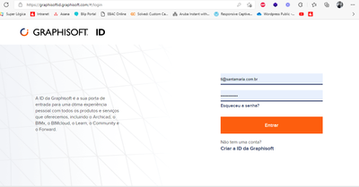

Hi!
I can't log in at the Graphicsoft login page on my software.
It only shows a blank page.
I tried to follow this tutorial, but with no success.
I'm using Windows 10 on latest build.
Archicad Solo 25.
Any ideas?
It's not antivirus, firewall...

Could you login into graphisoftid.graphisoft.com and send a print screen if it fails, please?
It´'s just like de image above, but on Windows 10.
Vinicius Guedes
Graphisoft Alumni
Graphisoft Alumni
I mean, could you open your browser, go to graphisoftid.graphisoft.com and try to login, please?
Oh, right. It works directly on browser, including IE 11.

Hi Minh,
I have the same problem here with a student, who can't sign in via Archicad 25 on Windows 10 ( sign in Window is empty). Browser login works with no problem. I've added the *.graphisoft.com to the trusted websites in Internet Explorer but this doesn't change anything.
AC 16- AC27
WIN 10 , Mac Studio OS 12.6
Hi Gino,
Thank you for the question!
This issue seems similar to the one posted here. The solution was, due to a driver issue in a new graphics card from Intel (Intel Xe graphics), the page could not be load. Could you please ask the client to check whether they have this type of graphics card in the system and make sure that it is updated?
