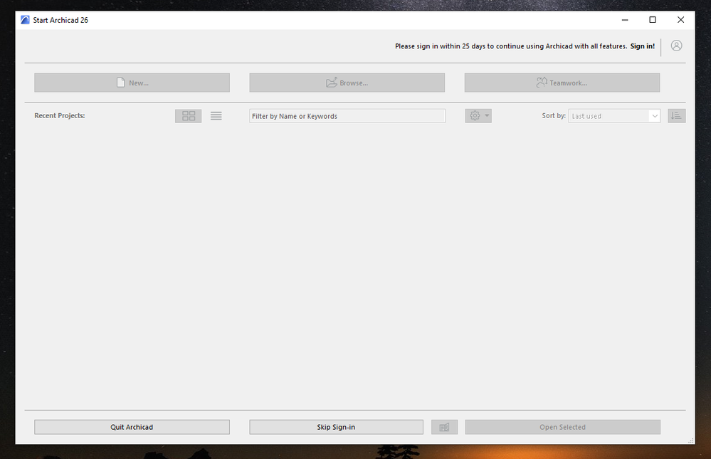

I have a new computer and loaded 26 with all of the latest updates.  License is current and loaded onto the computer and showing as active.  Every time I open ArchiCad I get the message as seen in the attached screen shot.  The bold sign in text in the upper right cannot be clicked, nothing on this message works, non of the buttons work except "skip sign in". So that's what I do, however I expect that within 25 days that won't work.  It seems to think I am working under a temp usage but there is no way to sign in.
How do I fix this?

Does the little person icon next to sign in not work either?

When you get into Archicad you have the option to sign in under the menu > Help > Sign in...
or by clicking the GRAPHISOFT ID in the lower right corner.
