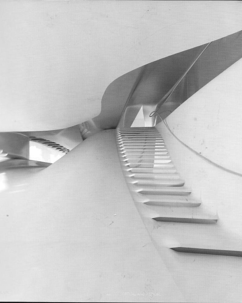

hi was hoping if any1 would know how 2 create curved walls and ceilings iv tried the mesh tool..but no success 4 me im kinda new 2 the archicad n would appreciate any help or advice thanx!
anything similer to the below pic would b great

Stop your planar thinking.
These shapes are made with curved wall with a complex profile.
Make a swoopy section and then trim it with a Solid Element Operation [SEO]
Once you establish the ceiling geometry [in my illustration, the wire frame as a complex profile extruded as a wall], then you make a slab to match the irregular planar size and "Intersect" the SEO.
These section shapes can be stair or ramp-like, tilted and doubly-curved....
