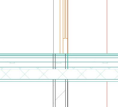

slab intersect the wall help plz
i want to know how to make the slab priority under the door more than the wall coz the slab continue so can i have some help plz.
here is the screenshot

It looks like you do not have it modeled as it will be constructed.
i think that slabs must be subtracted from the wall for the plaster fill get itersected
The wall should not be penetrating the slab in the first place. Partition walls should be modeled on their own story only. The fact that they line up floor to floor is just coincidence. Multistory walls should only be used when they truly are multistory and even then stacked walls are often preferable.
