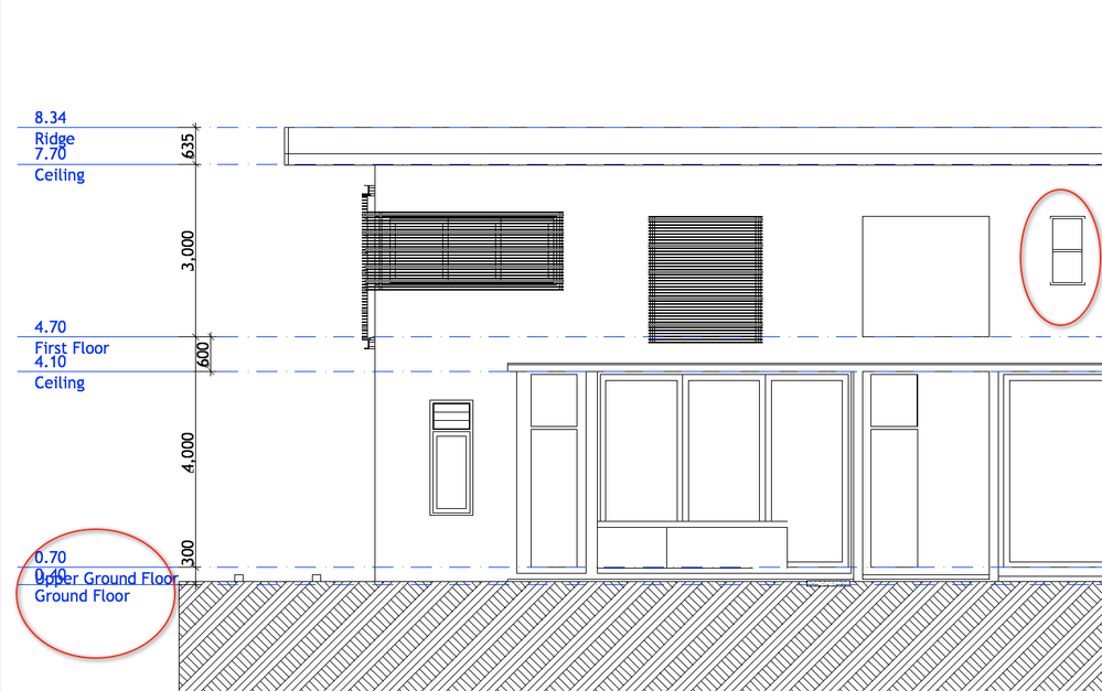

Storey Levels: Does anybody have a work around to prevent the clash of storey names/levels as in this examples?
W Ribbon 12: Why are the sides of the window missing? I'm sure i've solved this issue before, but for the life of me I can't think of how I did.
Any help greatly appreciated.
Mike

iv wanted this for ages.. at least have the auto text movable or something.. iv got to the point where either its 1.2mm high and the guys on site have a cry about it being to small or i just remove it and add my own. which i don’t like cos it leaves room for error if we make changes down the track.
GeNOS, they are the exact issues I am having.......
Anybody have anything for this problem???
the window issue was solved by setting the window in from the outside edge of the wall. Because the wall and window frame were the same material, they were blending into one.
Mike
Mark Wallace
GS needs to 'add' a feature in the 'Section Marker tool' dialogue similar to what is already under 'Show Grid Elements' subheading where there is a check box labeled; 'Auto stagger grid markers if they overlap.'
It might be called; 'Auto stagger story markers in Section if they overlap.'
It would make sense to include it within the 'Story Levels' portion of the Marker tool in conjunction with selecting or loading a story marker.
Also a long standing wish.
Mark
