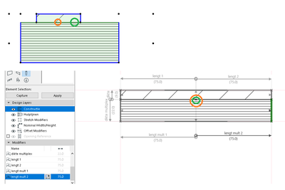

Hi all,
Any way workaround to have 2 complex profile strecht modifiers for the same fill so I can have a different size on top (A) than the bottom (B) ?

For the top fill make an extra point on the middle bottom edge (orange circle). That point is the start for modifiers to the right and left
For the bottom fill make an extra poin on the middle of the top edge (green circle) That point is the start for modifiers to the right and left

Why do you not just have your Profile Modifiers be your a & b? You can offset your edges, define the origin of your offset, then move the edge back.
Ling.
