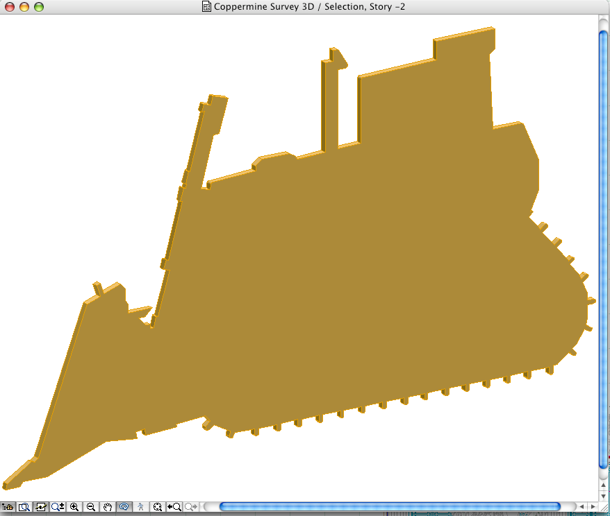

fessel28 wrote:
Is there a way to take another file, not sure what type, but to bring it into ArchiCAD, and extrude it to make it 3D. I'm asking cause the building we're designing has a huge sign on the exterior, and it needs to be 3-dimensional for the model. Is there a way to do this, and if so, what type of logo file might I need, and how to do it. Thanks. 😃
If the sign is fairly complex and you need different materials and depths doing it from slabs (or combinations of slabs & complex profiles) in the plan window and then looking at it from the top in 3d saving it as an object is probably the way to go. I did this for a laser cut Caterpillar logo on a recent project by tracing a pdf of technical illustration they provided. A caution though. On this object when I tried to get the cut outs inside the cab and treads I kept getting errors because of the openings being so small, ArchiCAD kept thinking they intersected themselves giving error messages. So I just used this on the model and exported the full detail as a dwg which is what the laser cutter needed anyway.
