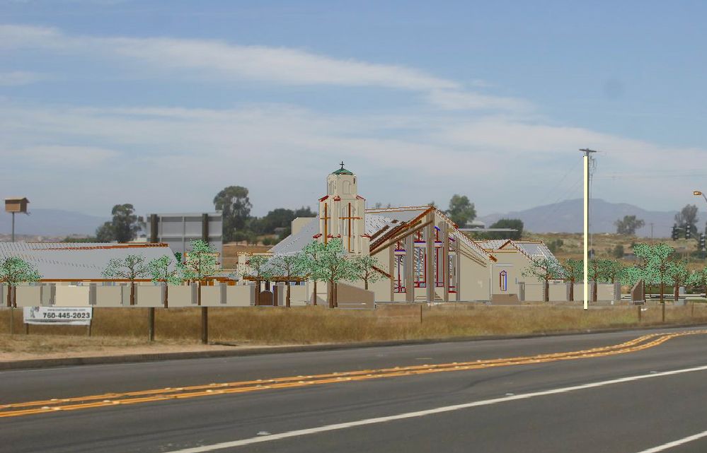

During the Save As... routine, the 3D model distorts certain elements, in this case the roof. (Notice the roof distortion adjacent to the bell tower and near the ridge of the roof to the left.) This happens in jpeg, pdf, tif, etc. Any ideas as to how to prevent this?

What does the image look like in the 3d window on your screen? Can you do a printscreen and attach the cropped image so we can see what is distorting.
Are you using the internal engine or openGL engine to produce the image? Check in the 3d window settings that you haven't got contours set to 'draft' perhaps. I don't know if this effects the save-as output or not.
You could also try turning off the trees before saving the image. Maybe the extra polygons are doing something strange to the model!

What I see in the image is that there appear to be multiple roofs occupying the same space. You get that 'shimmering' business when one or the other is trying to show itself.

I am on an Intel Mac, ArchiCAD v12, OpenGL, contours set to 'Best'. The Trees are important, as this is for a regulatory review. I have saved a very similar view a couple of months ago and it came out fine. The only remarkable differences are fewer trees before and different sun angle.
I am using small roof pieces for metal roof battens over a standard roof. I raised all the battens 1/4" and that seems to have done it! They were resting on the main roof plane, and now they float.
In our experence this is a major bug. Even when an element is physically above another (ie a slab located an inch or two above another slab) you can still have parts of the lower element "peek" through the upper. This only happens with the open GL engine. It is a total drag and basically breaks the ability to save (for example) interior flat shade perspectives (typically saved as a series of PNGs as part of a fly through).

Yeah, I've only seen this behavior when two elements are co-planar.

Maybe I'm just cursed. To clarify: everything looks good in the 3D window, it's only when you SAVE from the Open-GL window to a raster format like JPG, GIF, PNG that things start to look funky. Definitely not WYSIWYG.
