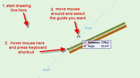

Is it possible to go back to the way guides worked in 14? I do not like the they way they have been changed in 15.

The simple things like drawing a line at 45 degrees from a starting point. What happened to that???? Drawing a line parallel with another line???
Make sure in your Work Environment under Guide Lines you have the incremental angle set to 45°.
Then it is exactly the same as before.
Start to draw your line (pick first point).
Then hover mouse over the edge you want to me parallel to and you will see an orange spot appear.
Click on that spot to activate the guide line.
Now you will have parallel and perpendicular guide lines to this default guide line just as before.
If you want to activate a guide from a point after you have started to draw a line then do as per the attached image.
If you want to just start drawing a line from a known point at 45° (or whatever angle your incremental guide line angle is set to) then just hover your mouse over the point before you start to draw the line and press the keyboard shortcut for guide lines (`).
Then move the mouse around and choose the guide line you want.
