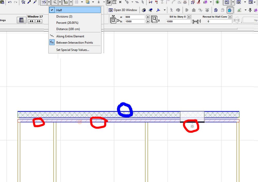

I have problem with putting windows in AC 17 ...
If i have 3 room with one exterior wall... and I want to put window in the middle of each one oh them ...I choose half snap with <between Intersection points > like red point in attachment
that was easy in AC 15
but in AC 17 it forced me to pick exterior side of the wall < sun cursor> and it will pick one point ,that is middle of whole wall. blue one
in AC 15 can use mirror in AC 17 if I use mirror or flip it changes the side of opening window or door and dose not change the position of reveal ...
anyway to move snap from inside wall to outside ..or flip window completely .

Yes I like the old method as well.
What you have to do now is to place a guide line first.
It can be done while placing the window if you have the auto guide lines turned on.
Select the window tool, touch the inside wall to get the midpoint marker then use the 'guide segment' tool button or SHIFT+` keyboard shortcut to place a guide segment at that mid-point, now place your window.
That is a little easier I think than placing the window incorrectly on the inside of your wall, then rotating it about the centre, mirroring it about the centre and possibly having to 'Flip" it as well depending what side of the wall your last click was.

Agree that the old method was better. Another option after finding the mid-point on the inside face of the wall is to hit option/alt "x" or option/alt "y" to constrain the cursor location, then moving to the exterior face of the wall to place the window.
It still works for me.
The trick is to first hover over the inside face of the wall until the center "tick" mark appears,
then quickly move the cursor to the wall's reference line and the tick will appear again (@ cent. of room, not entire wall).
As long as the wall's ref. line is located within the exterior half of the wall, you should be able to ge the "sun" symbol on the exterior side of the wall.

thank all ..
after trying ..I find the best way It to change reference line to exterior side ..before or after drawing the walls ..IT will force interior walls to reach the exterior side ..and snap will work ..
