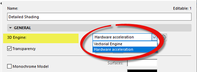

Also try the 3D window with the Vectorial engine rather than the OpenGL engine (or Hardware Accelerated engine I think they call it now in 25).
If that works then I would suspect the graphics card.

I was not referring to Hardware Acceleration in the Work Environment.
In the 3D Styles you can chose the engine to view the 3D model with.
Vectorial is a bit slow but if the 3D model does not crash, then you know it is not a model problem.
OpenGL has been renamed Hardware Acceleration in 25 (because Macs no longer use OpenGL I believe).
