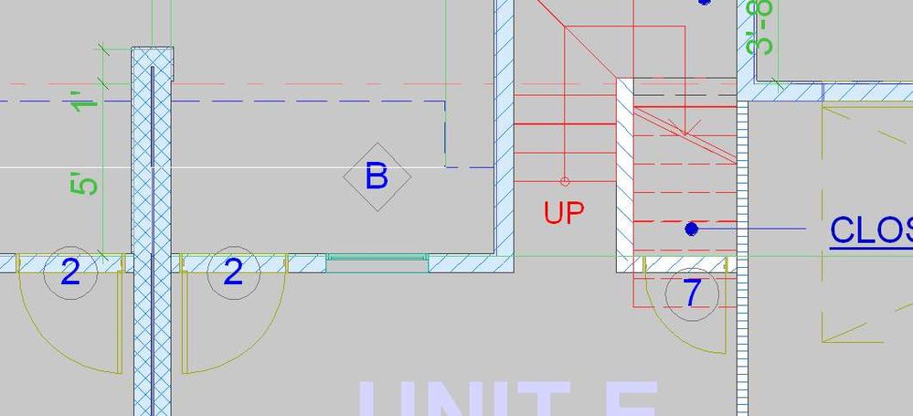

Does anyone know why some doors show the wall going right through them as shown in this image? They are D1 Entrance 11, D1 Int Door 11, & D1 Garage 11 - so far.
This is an AC10 project migrated to AC11. If I unload AC11 library and reload AC10 library, the door openings come back. I haven't done that much work in AC11 yet - so is this a good time to scratch that and go back to the AC10 version file and continue in AC10? Or is it okay to just load the AC10 library and keep working in AC11? There's probably 1 or 2 rounds of plan check revisions left only.

Ok, I found out it is because of this file in the AC11 library that I modified as a work around.
http://archicad-talk.graphisoft.com/viewtopic.php?p=94997&highlight=trim#94997
It's a no win situation for me I guess. In order to migrate to AC11 I have to change this library part, but if I do, I get this problem.
I think I will just finish the project in AC10...

Ok, found out the culprit in my original file that led to all these problems. It was because of my garage doors, that I put in a composite wall - but set it as a "solid wall" in the door settings because I didn't want to have 1/4" r.o. hotspots. When I changed the settings to "stud wall", the file works fine in the default AC11 + AC10 subset libraries. Guess those rough openings are pretty important!
All the doors' openings work as expected now w/ the standard libraries.
