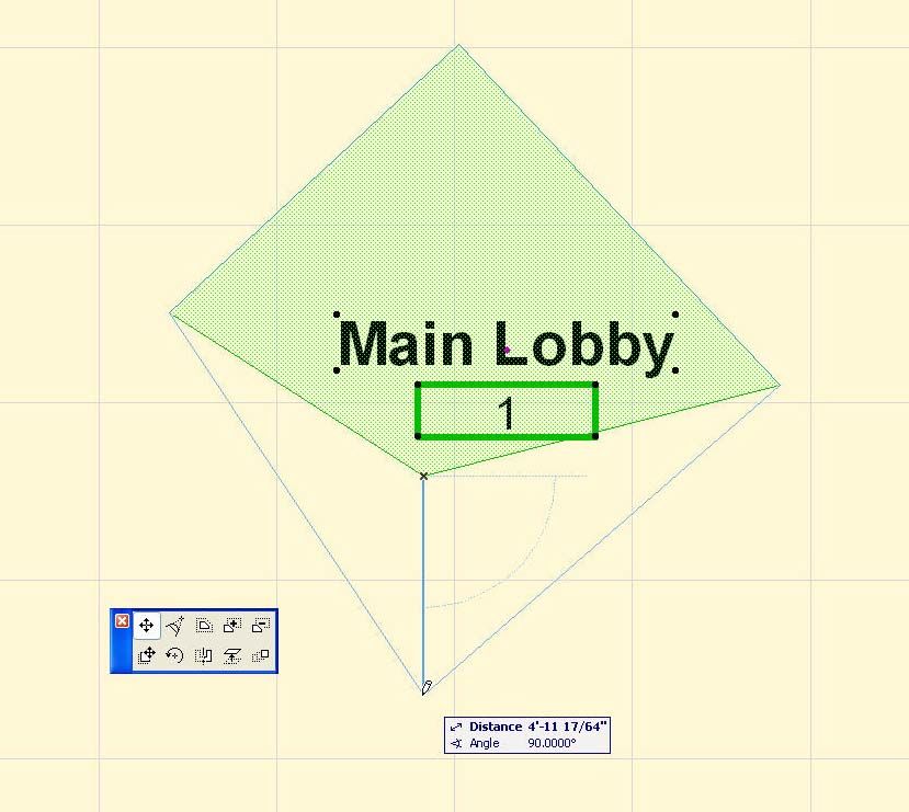

You can now reshape a Zone without having to have it's background fill displayed.

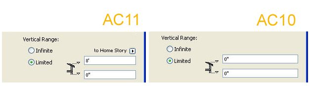

The "Vertical Range" within the S/E and IE dialogs can now be measured from the Marker's Home Story (instead of limited to Project Zero).
