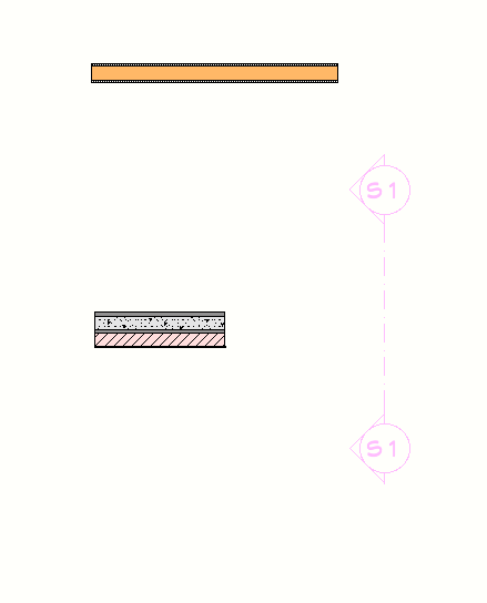

I have elevations of 4 sides of a home. All has been well while working on the project. Turned vector hatching on "south' elevation.. normal. Turned vector hatching on east.. frozen solid. North.. fine. West.. frozen solid.
So, one direction fine.. one freezers AC and results in a force quit. I tracked it down to one composite wall. Isolated the wall and sure enough, generating an elevation of the end condition freezes AC. However, for whatever reason I was able to delete the wall, and redo the same composite and it is ok. I don't know.. but something is not right. On the attachment, only the block/brick wall froze AC, but not aftrer deleting it and replacing it "fresh"????
Moral - if AC is crashing with vector hatching on while generating an elevation, look for an end wall condition.
During this, all 3d's worked fine.

was this a new v11 file or one started in 10? Don't know if it would make a difference or not but thought I'd ask.
Today I had the same problem with fill & vectorial with a project coming from AC10. Just froze with out a report. Can not get ride of the problem, so for now I not doing fill & vectorial on elevation of this project.
