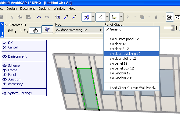

I can't seem to create a door in one of the panels. When I look up what to do in my manual, it shows that there should be several door choices. But mine shows none. Do I need to load something or what?
gkovacsp
Default ArchiCAD 12 Library should be fine.
Select the Curtain Wall and push the Edit (in 3D) button on top of it.
Select the panel with the arrow tool and try to find the Panel Type dropdown.
