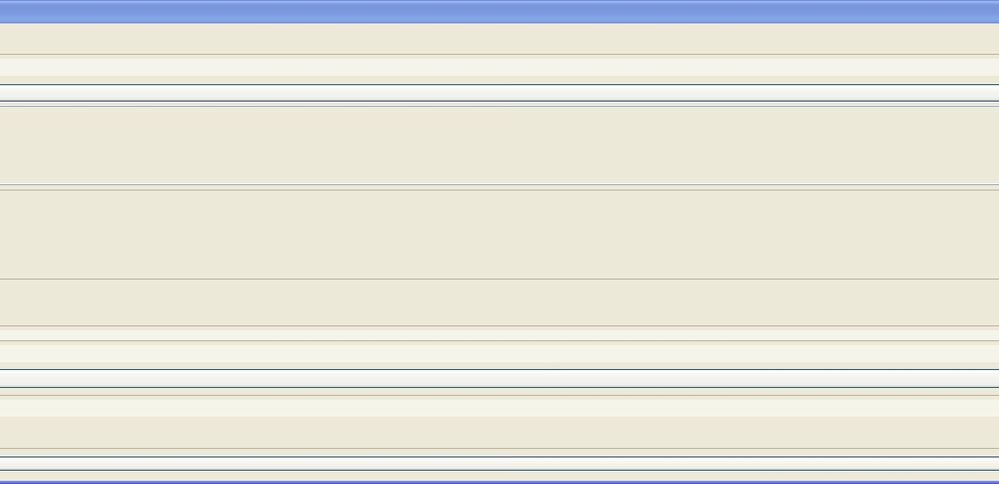

i have this kind of bug.
archicad 12 int
in curtain wall setings sometimes (mostly times) i have next problem
I have to big window of dialog. I cant resize it and i have to move 5 time to the right to see ok button
this is when i press system settings in 3d window or in floor plan
Is anyone have this kind of problem ???

Same problem on my Mac & with USA version.

We have same problem.
