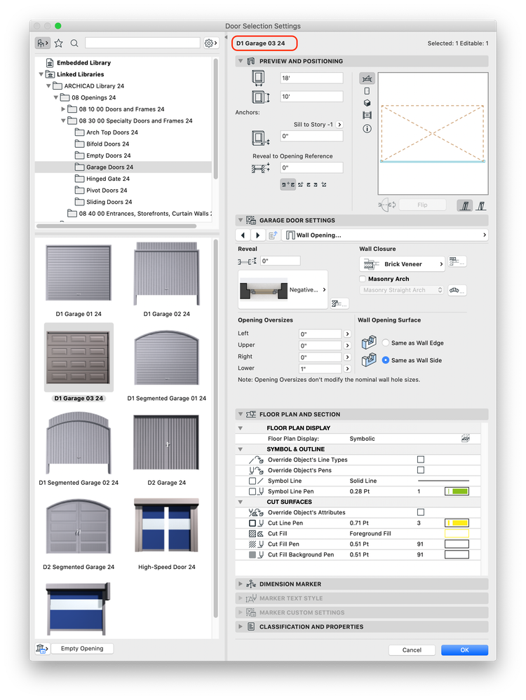

Hello,
I'm not sure if there is a way to update my library to fix this but in AC24 in any door object the "MODEL" submenu where you can Override Surfaces is missing. That submenu exists in AC25 but not AC24, see attached screen shots. What makes it a problem is the Override Surfaces in AC24 is turned ON by default. My current workaround is to copy the wall with the door object from AC24 and paste it into AC25, open the object and turn off the override, Save As AC24, then open that saved file in AC24 and copy/paste into the original file.

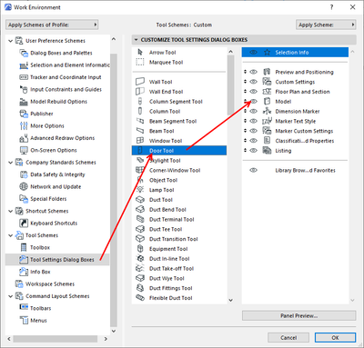

Have a look in your Work Environment > Tool Setting Dialogue Boxes > Door Tool.
Make sure the 'Model' panel is turned on.
You will want to do the same for Windows and possibly other tools as well.

My man! Thank you. I don't know how those got turned off because I've certainly used them in the past. Maybe my Work Environment tool settings got messed up somewhere. But this has been driving me nuts and now it's solved. Thanks again.

I don't know why, but it is off by default now in the standard Work Environment.
