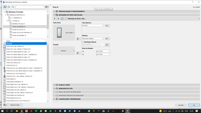

Hello.
Is there a setting that lets me keep the preview tab and definition tab open at the same time?
As I try to open the definitions tab the preview tab closes.
Thanks!!!
1 ACCEPTED SOLUTION
Solution
Sounds like you have quite a small screen/resolution.
The sections of the dialogue box will close by default when you open another and they both can't fit on the screen.
There are options in your Work Environment you can play with but you may find you then have to go hunting for what gets pushed off screen.
Although for me at the moment in 25 they don't always seem to work as expected when I turn them off.

Do you have 125-150 scaling in Windows settings?
AMD R7 2700 3.8@GHz | 32 Gb RAM | SSD | GTX 1050Ti
Joachim Piper
Well, yes, I had it on 125. With scaling on 100% problem is solved, except I need some galsses now. Thank you!
