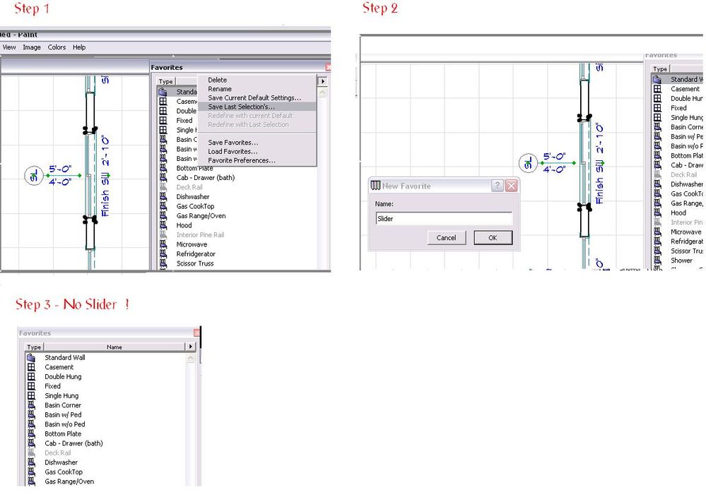

I am no longer able to save favorites. My Favorite list originally came from a AC 8.1 PLN. I have saved and redefined the four windows shown. I can not seem to save any more window selections?
1 REPLY 1
It seems that the windows that were existing within my previous Template file in AC 8.1 could not be saved as Favorites within AC9 until I placed a "fresh" window with thoses setting. I Alt-click the existing window then place in a wall Alt-click the newly placed window and in Favorites choose "Save Current Default Settings".
