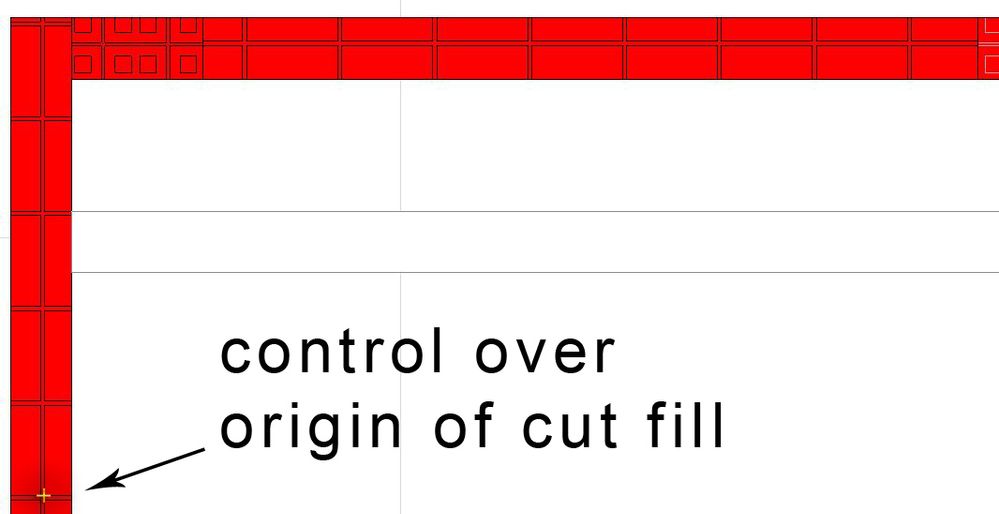

How does one cotrol the origin of the cut fill as displayed on Plan? I want to be able to show individual bricks on plan. See attached:
Any suggestions welcome.

Thanks... fixed it. Any genius answer yet?
Hi... As I'm not a master in archicad ... I'm not sure its the best way or not ! but you can make a detail or worksheet of your section which you draw and then select the cut fill , change the " construction method " in Fill selection Setting From " Relative to the project Origin " to " relative to the fill origin " then change the Origin Of your fill brick.
